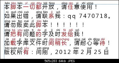

Haha, I don't know if you guys need this kind of thing.({
You need to create a new folder on the D drive, name it "汉字加拼音", and put the text in
The Pinyin settings follow the ID Pinyin settings, and you can modify the rest of the values'beer1'

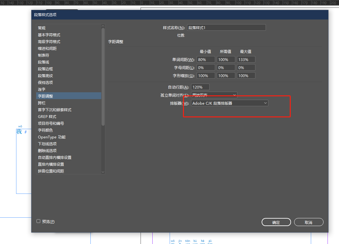

To convert text to pinyin, you need to change the paragraph to the screenshot option first, and scroll down the fourth in "Kerning ---typesetter"
Yeah, there is no such Paragraph Style's Сomposer option in my InDesign CS6.

Yes, the file name can be set by yourself
I ran smoothly on the 2023ID page,Your question I feel is the paragraph aspect
The name of the file may be anything you want as long as its name is properly put in here: var ziFile = File ('/d/拼音助手/汉字.txt')
