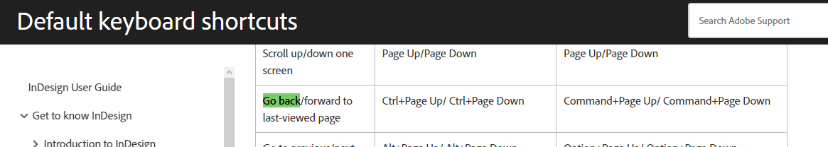

Ctrl + Shift + Numpad 3 Cmd + Shift + Numpad 3 Last page
Оно?
Ctrl + Numpad 9 Cmd + Numpad 9 Go back
Ctrl + Numpad 3 Cmd + Numpad 3 Go forward
